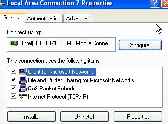

To enable file and printer sharing follow these steps:
Go to MY Network Places.
Click > view network connections < then go to its properties and check the file and printer sharing.Â
You can also set your IP,s for different computers to make a better network.
