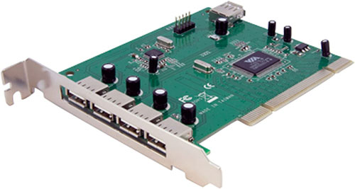

7-port PCI USB card adapter
On the other hand, if the keyboard works perfectly on the other computer, it means you have a problem with your USB ports. In this case, try using a PCI USB adapter like this one: 7 Port PCI USB Card Adapter.
