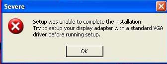

I have a Dell laptop running on Windows XP home edition. Because of a virus attack, all of my data were wiped out, including the recovery disk and device drivers.
I have installed a fresh copy of the operating system and downloaded all the drivers.
But I am facing trouble with my ATI Radeon X300 Card driver. When I try to install this, it shows an error:
• Setup was unable to complete the installation.
• Try to setup your display adapter with a standard VGA driver before running setup.
• [OK]
When I press the OK button, setup stops and closes the window. I am unable to understand what I should do next.
I have ATI Radeon X300 Version 8.2, which is the same driver I used before the crash.
Though I can see the display, but it is not good and can’t be set in 1024×768 pixel mode.
Can anybody provide me with guidance?

Download this ATI Radeon X300 Catalyst Software Suite v.10.2. Here is the link.
https://driverscollection.com/?file_cid=42111936768a52d7838333c135c
  • After your download is finish, uninstall your ATI Radeon X300 Version 8.2. Restart the computer.
  • Install your ATI Radeon X300 Catalyst Software Suite v.10.2. Restart the computer.
  • If your computer does not have the updated .NetFrameWork you will receive an error because Catalyst Software requires an updated .NetFrameWork.
After you have restarted the computer, Catalyst Software will prompt you what type of .NetFrameWork you will need to update. It could be 2.0, 3.5 or 4.0. Just update your .NetFrameWork and restart your computer then you can now you can use your computer normally. You can adjust your preferred screen resolution.

I successfully downloaded the missing driver. Thank you all for playing a major role on fixing it. Thanks also to techyv.com.
