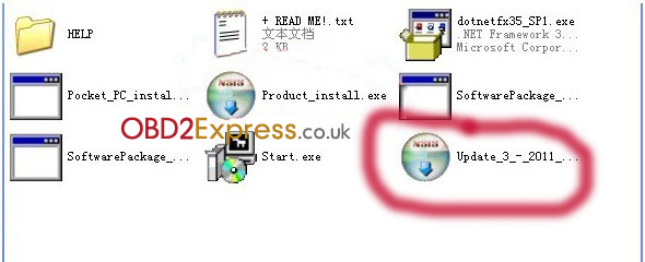

Hello there,
The error that you are facing is because of installing the software incorrectly. You have to install the update inside the installation folder. After that try to upen it again.
Alternate method:- (Try this when the above solution doesn't work)
Delete all the files from the Autocom folder in the Appdata folder.

This problem exists in your installation process. Follow these solution to fix your problem.
Solution 1: You need to install the update in the  2011.3 software.
Solution 2:Â You can delete the files: C:Documents and SettingsAll UsersApplication Dataautocom.
Hope after that your will not face anymore problem.
