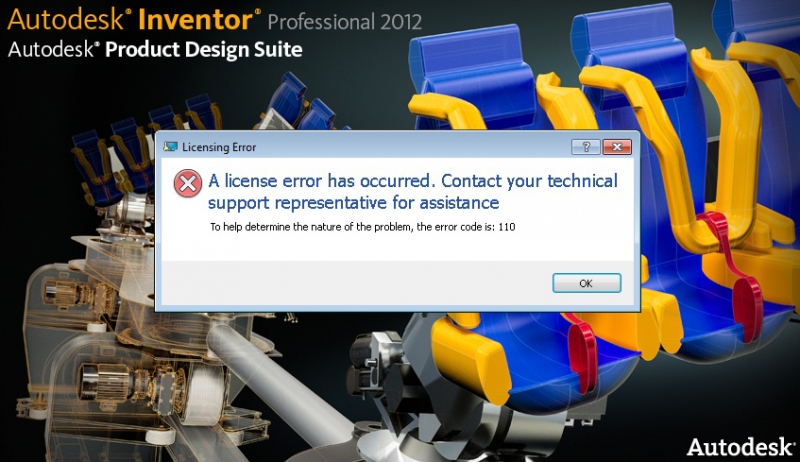

I encountered this error when I installed Autodesk Inventor for the first time in my PC.  I tried installing again but I got the same error.  I knew I had a valid license so I wondered why this error happened.  Can you help me, please?  Don’t know what to do next.
Autodesk Inventor Professional 2012
Autodesk Product Design Suite
A license error has occurred.  Contact your technical support representative for assistance.
To help determine the nature of the problem, the error code is: 110

Hi Stephanie,
The error code 110 your computer encountered with while installing Autodesk Inventor indicates an “Error creating a request”.  The issue or problem may be occurring for: 1. during the installation the ASR folder was not created or 2. There are some ASR files which are missing from ASR folder.
Uninstalling and reinstalling the product normally fix this problem. But before doing so you need to find out whether the issue is with a missing ASR folder or with missing ASR files in that ASR folder. Also do check administrative privileges on the machine. Always try to install by ‘Run as Administrator’.The ASR folder path is given below and check whether it is there or not:
Vista/win7 – C:ProgramDataAutodeskAdlmAsr

You need to install the software in correct manner. I feel you have missed one trick. You have installed the software in other mode and not in administrator mode. This is causing the problem and your license is not being authenticated. Hence uninstall the software and then run the computer in administrator mode. Now in administrator mode, install the software and you will find software to accept your license and the problem will be resolved.
