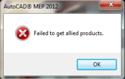

I want to uninstall (for repairing or get solution is) my product of AutoDesk. But, the error message in the screenshot doesn’t allow me to do so. What can I do? Can you please tell me?
Failed to get allied products.
AutoCAD MEP 2012

This error is coming from the operating system (OS) meaning, that the OS is not able to find the software to remove it.  The reason for this error some of the  autocad files got deleted  unknowingly. You will need to try to remove it with a third party application. . You can also try REVO Uninstaller Pro by downloading the 30 day trial. This software has the ability to force an  uninstallation of any software from your computer. If you are unable to remove the Autodesk software you will have to get your IT to reimage your machine as there is no other way around this error.
