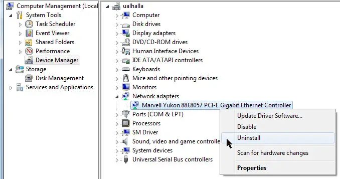

When it is finished, close the command prompt then restart the computer. After booting, open your web browser then visit a safe website like Google.com to verify if the internet connection is back. If you still don’t have internet connection, try to uninstall and reinstall your network adapter. Click “Start” then right-click “Computer” and select “Manage”. In “Computer Management” window, select “Device Manager” on the left pane.
In the middle pane, expand “Network adapters” then right-click your network adapter and select “Uninstall”.
Uninstall network adapter in Device Manager
When it is finished, restart the computer. After booting, install your network adapter back. See if this fixes your internet connection. Also, try checking your network cable. Disconnect the network cable from the network port at the back of the CPU then plug it back in. See if this works. If this doesn’t work, disconnect the other end of the cable from the Wi-Fi router then connect it back.
