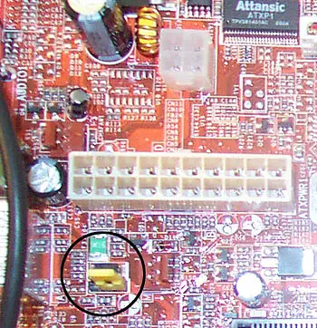

Probably your motherboard contains a jumper that you can use to clear CMOS settings together with the BIOS password. The location of this jumper will depend on your motherboard's brand name. Read your manual to see it.
It should look like this:
What you should to do, is remove the jumper and join the center pin to the opposite pin. Now just wait for a few seconds and then remove again the jumper and put the center pin to left pin.
Note: Be sure to turn off your computer before doing this.
