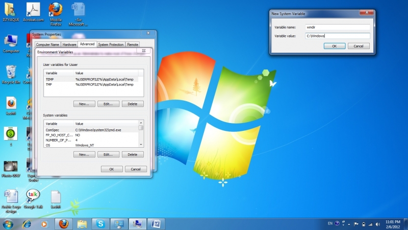

To fix the problem, use these steps:
* Login as Administrator or to a user account equivalent to this.
* Right click on My Computer and then click on System Properties.
* Click the Advanced tab. Click Environment variables.
* Under System Variables, click on New to add a new variable.
* Type windir as the Variable name.
* Type “C:Windows” as the value.
* At the end, Click on OK to close the dialog.
Note: The above assumes that Windows is installed in “C:Windows” directory. If Windows is installed onto a different drive or directory, you must adjust the path according to that or it will not work.
