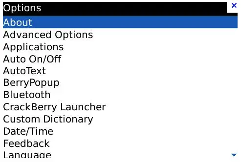

For your Blackberry GPS to work, you need to set it up properly. It needs to have navigational maps which are downloadable. Since maps are downloadable you need to be subscribed to a data plan and must have a radio signal. You have a built-in GPS in your Blackberry you need to have a Bluetooth connection, subscribed to a data plan and must be in an area with a high radio signal.
Then try to follow these steps. In your Blackberry Options click Advanced Options, click Applications, click TMJ-Mobile, click Edit Permissions. Be sure that the Connections/Locations Data is set to Allow. Go to Blackberry Options/GPS and set GPS Data Source to Device GPS; GPS Services to Location ON and Location Aiding to Enabled. Then, restart your Blackberry phone.
Then try to go outside and verify your GPS signal. Go back to your Blackberry options/GPS/Refresh GPS Function. Observe if the Longitude and Latitude is updating with the local values. If not, there must be something wrong with your Blackberry unit.

But thanks to Maze Angel I followed the steps she gave and it worked to my phone. My GPS now connects well and its fast. I suggest that you must follow the solution given by Maze angel. If doesn't still work contact the manufacturer they are still liable for that.
