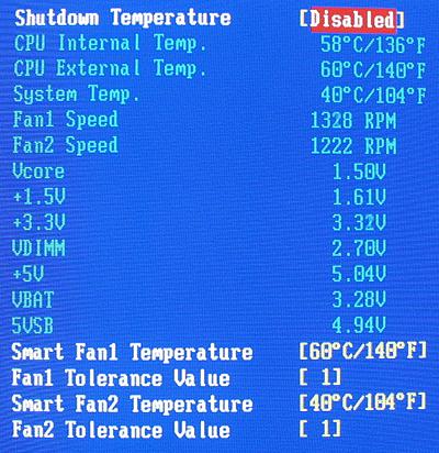

Your options are restart pc and go to BIOS setup and then Advanced CMOS setup then Temperature control.
Now enable turn off temperature and set your turn off temperature at 60 degree. Now save it and restart.
