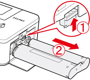

If dust gets into the ink sheet, you can use a blower brush or something similar to remove the dust without touching the ink sheet with your hands. To detach the ink cassette, move the battery cover lock upward then pull the ink cassette.
Detaching ink cassette from Canon SELPHY CP800 printer

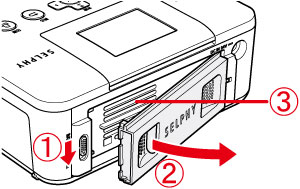

To remove or detach the battery cover, move and hold the battery cover lock downward then move the battery cover outward. After this, remove dust from the air vents.
Detaching battery cover from Canon SELPHY CP800 printer
