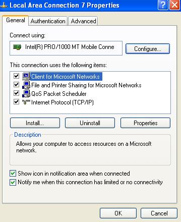

This problem occurs when the SERVER is not giving you access to use a network printer, it can be a fault of your PC also you have to check them both in this case. For this just go to START menu and select Control Panel now switch to Classic view here you will see your network connections. Go to its Properties by simply right clicking it and selecting properties.
Now Check that the option “File and Printer sharing “is checked as shown in the diagram..
local area connection
Anyhow you can also check the number of users that are using the printer if two users are using a service at the same time then it will also cause this type of problem on a network. May be your network not allows multiple access at same time.
