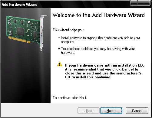

Other option is to search for new hardware from windows. For this go to control panel then click on add hardware.
Then select category and click on add. It will automatically install CD ROM driver software.
