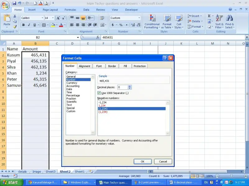

In your excel sheet the cells which you enter whole numbers may have formatted to two decimal places. Therefore you will have to change the decimal places to zero of the relevant cells in order to overcome this problem.
There are two methods that you can follow to change the decimal place.
Method 1
·         Select the area of cells that you enter the whole numbers.
·         Then right click on the selected area and click on the format cell.
·         Then click on the number tab and click on the number field.
·         Now change the decimal places in to “0” and click ok.
Method 2
·         Then click on the home tab and select the number format in the number section (see “I” on the image).
·         After click on the comma (see “II” on the image) and click continuously on the decrease decimal (see “III” on the image) until all the decimals are removed.
