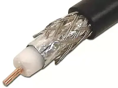

What's the best type of coaxial cable that I can use for my 2meter band radio transceiver if I'll be using a directional type of antenna with rotator? |
You are using a 2 m band radio transceiver. If we apply the formula: Frequency (Hz) = Wave speed (m/s) / Wavelength (m), where wave speed is the light speed.
We will end up with a frequency of 150 MHz.
For this frequency there is a wide range of coax cables that can be used, but the best to is would be an RG6 or RG213.
The main thing is that you buy a cable having the lowest loss that you can pay for it, the more the loss is lower; the better will be the signal.
