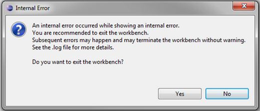

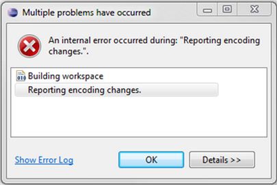

This is some strange error when I tried to import an existing project, the details of the error are also strange and after I click on the ok another error pops up that is asking me if I want to exit the workbench, anyone encountered this.
Multiple problems have occurred
An internal error occurred during: "Reporting encoding changes.".
Building workspace
Internal Error
An internal error occurred while showing an internal error.
You are recommended to exit the workbench.
Subsequent errors may happen and may terminate the workbench without warning.
See the .log file for more details.
Do you want to exit the workbench?

Hallo Jai,
Try the following workarounds:
  • First off, you will need to go to the Welcome Menu
  • And then you will click the icon for Samples
  • After that click the icon for SWT â€“ Workbench views and standalone applications
  • Next you will choose Workbench – Java Editor
  • And then accept the default project names, and after that click finish at Eclipse Samples.
If you still get the error, exit the  Workbench then end all process associated with ColdFusion in the task manager and then restart your computer and see if that will help resolve the issue.
