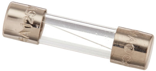

One possible cause for that is the fuse on your CPU’s power supply which probably got busted. Every electrical device like TV, DVD player, washing machine, and others has a fuse built into it. The fuse is a piece of electrical device or component connected to the power supply that protects the circuit from power surge which can damage the entire circuitry.
Glass cartridge fuse
When there is power surge like in the case when there is lightning, the first thing the surge of electricity will struck is the fuse.
Because the fuse has a specific voltage that it can tolerate, when the surge of power hits the fuse, because of the enormous amount of power that will flow through the fuse that goes beyond its limit, the fuse will break resulting to the cutting of the power breaking the flow of electricity.
When electricity is cut off, no further damage will happen to other connecting electrical components in the circuit. The only problem now is that your device will no longer start because of the broken fuse. Fuse can easily be replaced in the power supply. It will not cost you big money. Bring your CPU to the nearest computer repair shop to help you check the problem.
