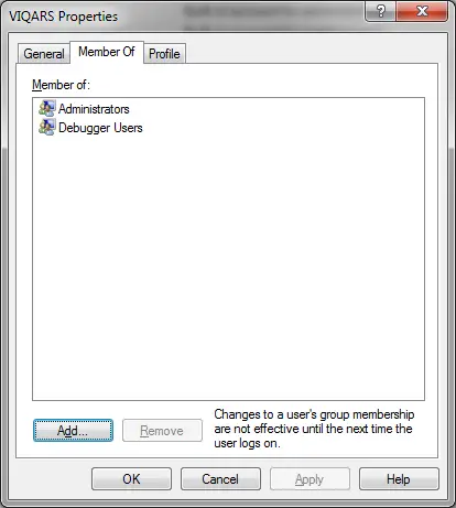

Go to the administrator login, right click on my computer, and click on manage
Click on local user and group on the left pane, and then on the right pane right click on your other user, and then click on properties.
On the open tab click on “member of” and then click on the add button.
Select the administrator, and click on apply and click on ok
You now should be able to work with your user ID and will not require to log on to administrator account
