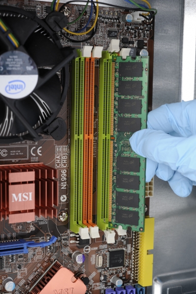

As what you described, constant beeping sound means a bad memory, or you just didn’t attach them properly.
Easy fix:
·         Remove memory stick, then insert it again in the proper position, see the photo.
·         If you don’t know which direction it should face, then just do trial and error. If the first position doesn’t work, then the second position will.
·         Then do this on all the other hardware
Important: Always attached or install hardware in proper position and not loose.
