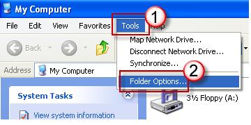

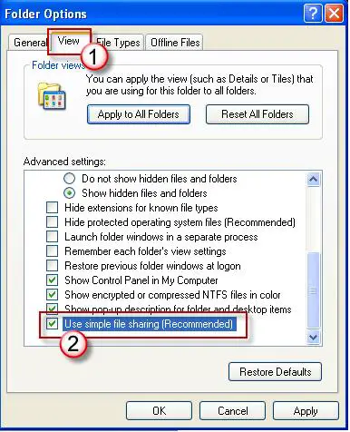

Please follow steps below to enable Simple File Sharing, this will most likely resolve your issue.
Start> My Computer>Tools>Folder Options>View tab>Use Simple File Sharing (Recommended)
