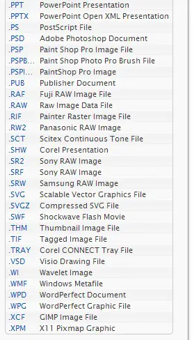

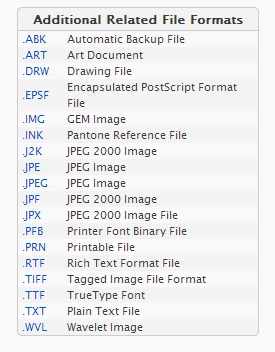

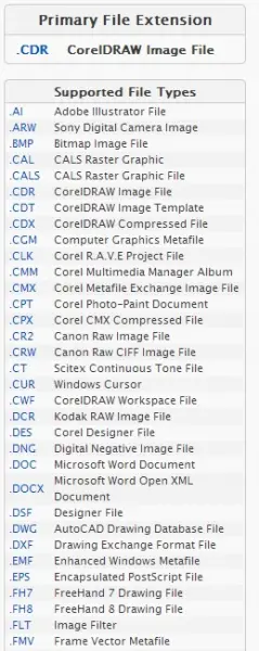

There are two possible explanations to your problem:
1. Clearly what you are trying to upload is a file which CorelDRAW supports. I’ve here a list of all the files that CorelDRAW X6 supports.
