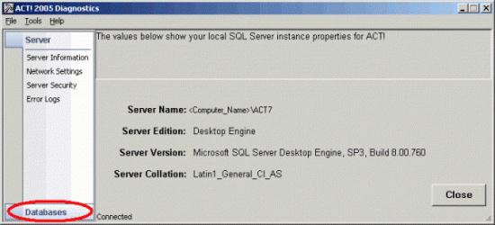

3. In the Open field, enter actdiag (ACT! 2007 and later), act8diag (ACT! 2006), or act7diag (ACT! 2005), and then click OK. The ACT! Diagnostics utility launches.
4.Click the Databases from the navigation bar. A list of your databases will appear.

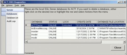

5. Click the rectangle on the left side of the DATABASE name that you wish to Detach. The entire row displaying the database information becomes selected.
6. Note the path in the DATABASE FILE LOCATION column.
7. Right-click the rectangle on the left side of the DATABASE name, and then click Detach Database from the shortcut

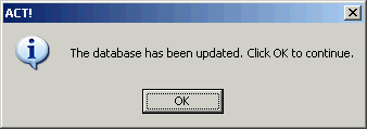

17. Navigate to the folder you created in step 13. Open your database by double-clicking the .ADF file. Opening your ACT! 2005 database after detaching it will force it to reattach to the ACT! instance of the SQL Server. The following ACT! dialog box appears.
18. Click OK to began the verification of your database. The following ACT! dialog box appears.
19. Click OK to open your database.
