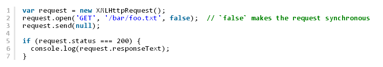

In line 2, the third parameter specifies that the request should be managed asynchronously. There are also a few cases where the use of synchronous request is preferable than asynchronous. See the image below for an example of synchronous request.
The simplest way of making the synchronous HTTP request
