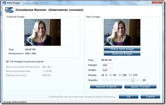

If that doesn't fix the issue, then you can use another software such as AD Photo Edit Utility by going to this website; http://www.cjwdev.co.uk/Software/ADPhotoEdit/Info.html
Once you download the software, you can open it and click Install then follow the prompts they will be displayed.
Once you install the program, you can then follow these steps to start using it;
Search for the username and click edit image for the particular image you want to edit.
You will then need to choose Select new image then select the new image that you would like to have displayed.
Make the adjustments to the size and resolution of the picture and it should be in the perfect form it is meant to be.
