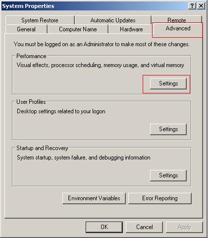

1) Click on start, then click on Control Panel
2) In Control Panel, Double-click on "System". If you don’t see the "System" icon, look for a link on the left side that says “switch to classic view”. See image below.
3) In the System Properties Window, click on the “Advanced” tab.
4) Click on “Settings” inside the Performance box.

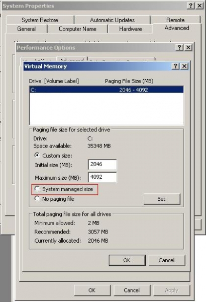

5) Go to the “Advanced” tab.
6) Click on “Change”.
7) Select “System Managed size”
8) Click on “Set”.
9) Click “Ok”.
10) Make sure you restart your computer after this.
11) Try running defrag again.
I hope this helps.
