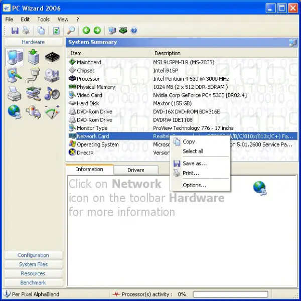

Searching for the driver using the IBM model of laptop or computer doesn’t solve the problem. Sometime yes but more often it can’t be solved. First, you must search for the hardware profiling tools on the internet. CPUID is the best tool for this hardware profiling job. CPUID developed a tool called the PC-Wizard. A PC-Wizard is a tool for benchmarking and profiling your hardware components. By this tool you can directly find the exact manufacturer and the model of your motherboard. Your motherboard’s profile or ID or the main board exact descriptions will be your token looking for your drivers on the inter. CPUID is the expert tool for this. If it is possible to print the result of your computer hardware profile for your reference.
PC wizard
After you’ve got all the information from your laptop look for the driver on the internet, exactly what the CPUID shows to you. Even if the IBM website doesn’t exist, you may find drivers from other sites. Most probably if you found the exact driver for your motherboard, all drivers like LAN, Audio, Video and others are also found in the package.
