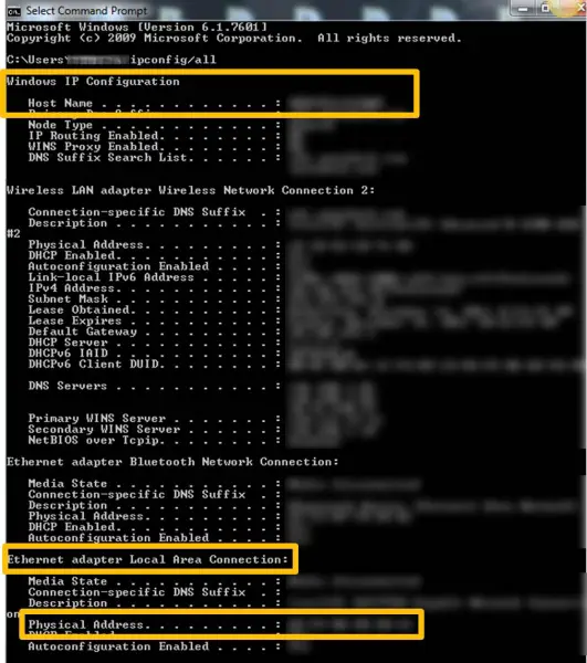

Hi expert, I need a help. Recently I downloaded the Autodesk 3D Max 2012. To activate I don’t know my Host Name and Port number. How to Find my Host Name and Port number? Is there any specific option to find it? If you know please provide the ideas. Thank you.
Good day! For instructions on how to retrieve your Host name and other details needed for your AutoDesk software, you can refer yourself to the tutorial they made on their main web site. They also provided screen shots to guide you along each step. Here I posted one of their screen shots. You may contact them directly if you wish to know more or need their help. Cheers!

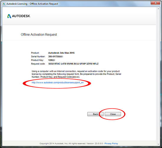

Copy or take note of the activation information given then click “Close”. Your request code should look something like this.

Note: to request an activation code online, you need your product name, serial number, product key, and request code. Plug your computer back to the internet. Now, go to Activate Offline with Activation Code (Perpetual) then scroll down until you see “2. Request an Activation Code”. Here, click the “Get Activation Code Popup” link.

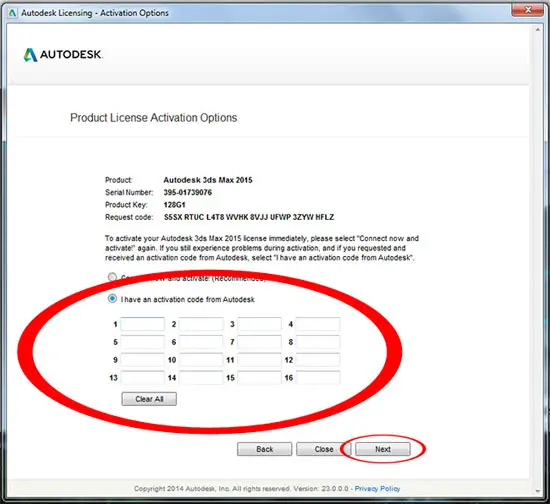

Follow the instructions then enter your contact information, serial number, email address of the purchaser or software administrator, and the request code you generated. All these are required to get an offline activation code. Copy your activation code. Now, to activate your product manually, again disconnect your computer from the internet then launch your Autodesk product. On the “Free Trial” screen, click “Activate”.
Next, enter your serial number and product key then click “Next”. On the next screen, select “I have an activation code from Autodesk” then enter the activation code you copied earlier and then click “Next” to complete the activation. You should see this screen when activating.
