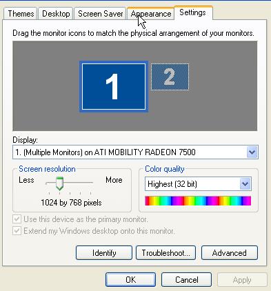

If you want to test your program, you can use “VMWARE" as it contains all the operating functions and it can easily solve your task. VMWARE software is a software which creates different windows and thus works as real Windows. But in case you want to use two monitors, then you can just get the same result on monitors but you can switch these monitors as per your requirements. I will tell you how it is possible.
It is a very simple task, only when you are using a laptop and one LCD or monitor you have to just plug your monitor into your laptop graphics and then simply turn on your monitor. After this, press the key which is shown on laptop keyboard to connect to other graphics, then it will use both screens. Although, you are using two monitors, you have to use also a special VGA card for two outputs. After you arrange it, do the following things.
Go to CONTROL PANEL select go to DISPLAY now in SETTING tab click IDENTIFY as shown here:
Now apply these settings and you will be done.
Hope you like this.
