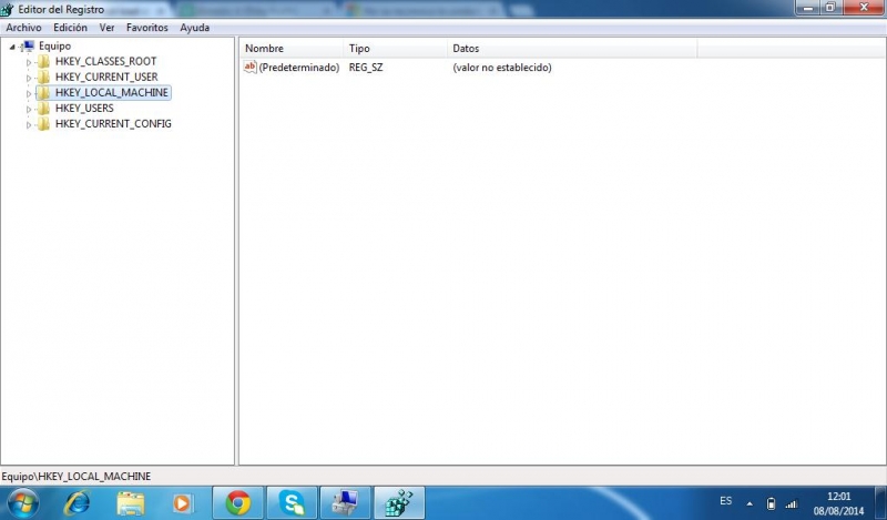

2.1 Go to start, type regedit,click on the line appearing above"regedit" and then click on yes. You will have something like this:
                   SCREENSHOT-OF-THE-REGEDIT-MENU
Click secuencially on:
HKEY_LOCAL_MACHINESYSTEMCurrentControlSetControlClass {4D36E965-E325-11CE-BFC1-08002BE10318
2.2 Choose Upper Filters register first on the right. If you find it, delete it
2.3 Choose Lower Filters and do the same as above.
After you changed values, close the regedit screen and then restart the computer.
