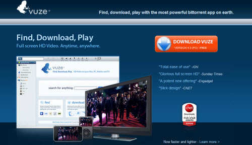

For DVD burners, this type of error only occurs when your DVD Burner was corrupted during the backup process. As a solution, it needs to be reinstalled. After installing, relocate the installation folder to another partition drive. Do not save it on your external drive as it may be more susceptible to viruses. Installation can be done by using the CD installer you have used to install it or search for the Vuze home page and click Download.
