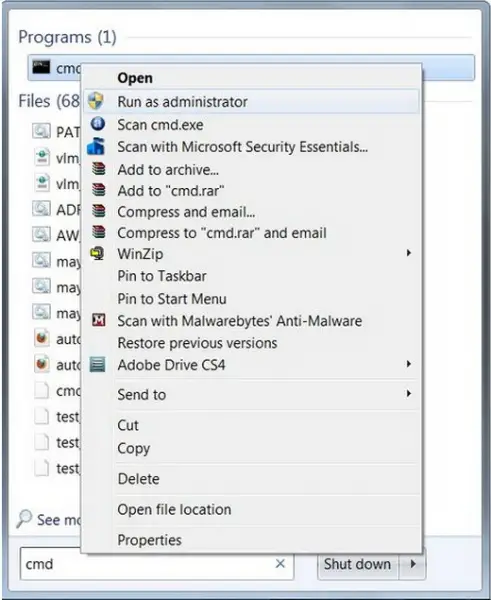

The issue may occur if you are trying to register a DLL by using Regsrv32 while you are logged on using an account that does not have administrative privileges. An account that does not have administrative privileges cannot write to the registry or change files in the System32 folder.
In that case, you can log on to the administrator account and then try to register the DLL. Either you can follow such steps in Windows 7:

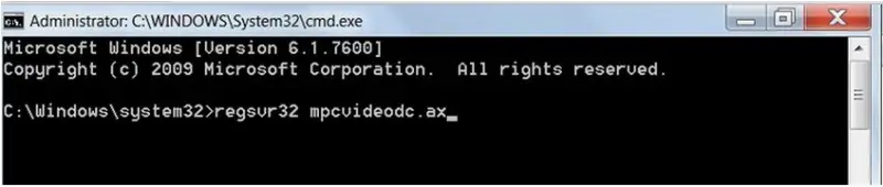

Go to Start —-> Search for command prompts (cmd) —-> Right click on 'cmd' —> Click 'Run as Administrator'.
Then type regsvr32 mpcvideodc.ax and press Enter.
Run as Administrator Registry or change files in the System32 folder
I hope it will resolve your issue.
