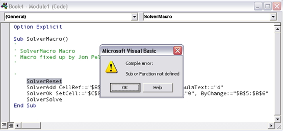

If I try to run this macro, I will get a compile error. The command SolverResetis will get highlighted, and the error message appears.
Microsoft Visual Basic
Compile error:
Sub or Function not defined
        OK              Help
An error occurred in Macro`s error in VB
A Sub or Function must be defined in order to be called. Causes of error:
1) Misspelling the name.
2) Call a procedure from another project without adding a reference(in the References dialog box).
3) Specifying a procedure, not visible to the calling procedure.
4) Declaring a Windows dynamic-link library (DLL) routine, that is not in the specified library or code resource.
To correct this error, you may try this:
1) Make sure that the procedure spelling is correct.
2) Check the procedure name in the References dialog box. If it does not appear, click the Browse button to search for it.
The attached picture states that SolverOK but SolverReset highlighted when you tried to run Macro. To resolve this issue try to set reference to SOLVER. How to do it? Here’s how…
