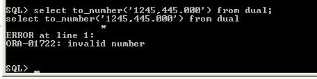

Dear Jessie, The ORA-01722 error main cause is wherever there is some conversion function is used in this case while converting some character string into numeric string. I will explain solution using an example. Please see the image below showing a SQL statement.
Here converting a string into numbers while “,” comma is not a number character that why this error occurred. Hope you understand the problem and will consider where you have gone mistakenly. If still problem persists please feel free to write me again. Will try to help you out with some other examples.
