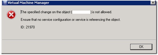

Hi People,
In my test lab I faced this error. I had built myself a new Service Template in SC 2012 but it failed to deploy.
For this, I decided to undeploy it but of no use. Instead I got this error.
Thanks for all solutions.
Virtual machine manager
|the specified change on the object {           } is not allowed.
Ensure that no service configuration or service is referencing the object.

Error – Virtual machine manager
Hi there user:
Here’s how to fix it.
You should remove the service by using the Powershell command which is ‘Remove – SCService’.
You will see then the ‘Service Name’ or the actual < Service Name > it’s a hyperlink.
Click it and it’ll show you the host group, and the service that was hidden. Delete it.
And that’s it, Service Template is now removed!
