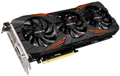

That’s definitely a problem with your video card and not with the video card driver. When your display suddenly flickers or goes black for no reason or displays some artifacts on the screen, it could be a sign that your graphics adapter or video card is failing.
NVIDIA GeForce GTX 1070 WINDFORCE OC
If you are using the built-in video card in your motherboard, you need to immediately buy a dedicated video card and use it to stop using the built-in video card. Because if you don’t and your video card stopped working, you will end up buying a new motherboard.
But if you are already using a dedicated video card and you frequently experience this problem, it’s time to buy a new video card to replace the old one. When a video card starts to fail, updating the video card driver will not help because the device itself is broken.
