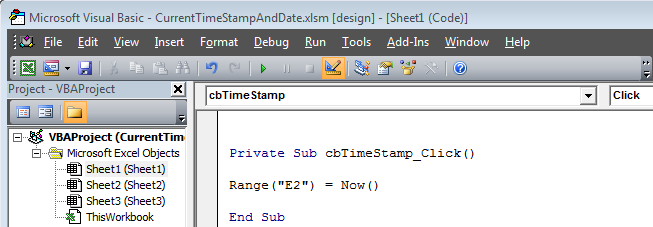

7. Make sure that the Design Mode button is enabled and then Double Click your command button ("Time Stamp") to go to the Visual Basic Editor.
When you open the editor you will immediately see that there is already a code written. Inside this code you will need to write the actions to be executed by the program. Which in this case, get the current timestamp.
8. After opening the editor, copy the code below and then paste it in the editor.
Range ("E2") = Now ()
The code should look like this.
"E2" is the cell where the output will be written so you may also change this to any cell you want.
