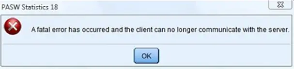

A couple of days ago I purchased PASW Statistics 18. But when I initialize this program it gives me an error message which you can see at below attached image. I have windows Vista 32 bit. Does somebody know how to resolve this program? I need assistance please

A fatal error has occurred and the client can no longer communicate with the server.

This is a common problem. The reason this is happening is because a locally installed firewall is blocking the Statistic program on your windows.
How to resolve this problem-
If so please allow access to the executable that launches Statistics.
spssengine.exe
paswstat.exe (PASW Statistics 18.0)
stats.exe (IBM SPSS Statistics 19.0)
Hope this helped your problem

Hi there
This problem occur because of the incompatibility between the version or incorrect permission setting
So in order to solve this problem try to give permission to these
Go to start > run > Type regedit and hit enter
Find these paths
·         HKEY_CURRENT_USERSoftwareSPSS
·         HKEY_LOCAL_MACHINESOFTWARESPSS
·         HKEY_LOCAL_MACHINESOFTWARENtpad
·         HKEY_LOCAL_MACHINESOFTWARERainbow Technologies
Give Full control to these files. In order to give permission right click on the file and modify and give full control
