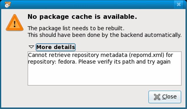

I'm trying to upgrade and install the Fedora software package with Add/Remove Software on Fedora version 10 but I get the following error message:
I need to solve this. Please help.
Error:
No package cache is available.
The package list needs to be rebuilt.
This should have been done by the backend automatically.
– More detals
Cannot retrieve repository metadata (repomd.xml) for repository: fedora.Please verify its path and try again

Good day to you. I have thoroughly researched your problem in the internet and these are the solutions I can offer:
An uninterrupted internet connection during the process is necessary. So first, you must be connected to the internet when using the Add/remove software. So open a terminal and log in as root then-
yum clean all
yum check-update
If everything seems ok then go for the Add/ Remove Software Tool again. Now you’ll see that you are no longer facing the problem.
And just to be sure you should check that your proxy settings are properly configured or not.
Also I advise you to use YUMEX for any Add-Remove something.
Hope this solves the problem!
