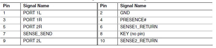

Your front panel USB cables are not connected to the motherboard.
To connect these cables to motherboard all instructions are available on the image below.

Front USB configuration
