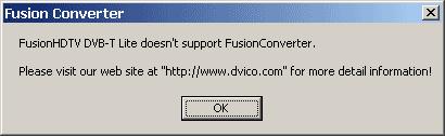

I am crazy about movies and videos. So friends coming to the problem, I converted Tp files to DVD or Divx and Mpeg2 it was good and no issues. It also works well to a core in 1080i, 576p and 576i, but problem is not DVB-T Lite. I am not a technical person, not able to proceed further. Please guide me.
FusionHDTV DVB-T Lite doesn’t support FusionConverter/

I don’t think there is really a problem when converting TP files although it says that FusionConverter is not supported on FusionHDTV DVB-T Lite. I think this is a pretty common error to users converting TP files since I was able to find several posts on the web regarding this error and one user fixed it by connecting the DVICO USB device on the computer when doing the conversion.
This was proven correct and able to fix the problem. So in your case, since you are using the FusionHDTV DVB-T Lite program in your conversion, you need to have the DVICO USB device to successfully convert it. Connect the DVICO USB device to your computer, start FusionHDTV DVB-T Lite, load the TP file, and then convert it. See if this also fixes your problem.
