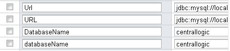

When you look at the properties of a JDBC connection on Glassfish management console, there are properties that have the same name but are typed differently. Depending on the middleware you are using this matters a lot. For example "URL" and "Url" sound the same but they are two entries in the properties section in the connection pool with the same value. I have attached a screenshot to help you understand.
