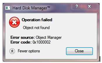

I am getting an error message when starting HDM Pro. I attempted to run the setup again and selected the Repair installation but I got the same error message. How can I fix this error? Any idea would be greatly appreciated. Bundle of thanks.
Hard Disk Manager
Operation failed
Object not found
Error source: Object Manager
Error code: 0x1000002
Getting an error message when starting HDM Pro
Hi Matthew,
I think you are having this error because the "archive_db" which is saved to your local drive C: is corrupted so to be able to fix this error you have to delete the "archive_db" file then restart your computer the correct file will be created automatically so don't have to download that file again. If the same error happens just delete it again and also delete the arc_db to make sure that will work this time then restart your computer.
