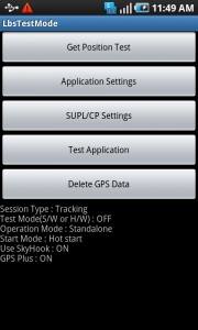

2. Following screen will appear

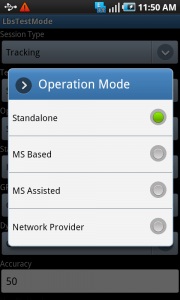

3. Click application settings . now click on operation mode and change it to standalone.
4. Click on start mode and change it to Hot Start.
5. Click on GPS plus and turn it On
6. Also turn on skuhook.

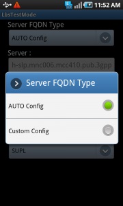

7. Go back to first screen and click SUPL/CP
8. Click on server FQDN and turn auto configuration On.
9. Now just restart your phone and enjoy using GPS
