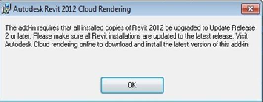

I get the error shown in the snapshot as I run the installer.
Autodesk Revit 2012 Cloud Rending:
The add-in requires that all installed copies of Revit 2012 be upgraded to Update Release 2 or later. Please make sure all Revit installations are updated to the latest release. Visit Autodesk Cloud rendering online to download and install the latest version of this add-in.

The error indicates that you need to upgrade your revit copy of the software in order to use the add in for it. For doing it use the following process.
  1. Go to the developer or the company website. See which the latest version is.
  2. After that, either download the latest version or go to the updates tab or menu.
  3. From there, choose which version you have and see what new updates are available for you.
  4. Download all the updates that you have not installed and downloaded.
  5. After that, restart your computer and launch the application again.
  6. You can now use the add in successfully and after its installation, a reboot is always good to have.

Installing an add-in, extension, or plug-in for an application is also like installing an ordinary software. You have to know the system requirements of the add-in. You need to know the add-in’s supported version of the target application.
If you have Autodesk Revit 2012 and you need to install the Autodesk Cloud Rendering add-in for Autodesk Revit 2012, you need to have the Service Pack 2 of Autodesk Revit 2012 or the Autodesk Revit Architecture 2012 Update 2. To fix the problem, go to Update 2 for Revit Architecture 2012 and download the Service Pack 2 update.
The update is available in two versions: 32-bit and 64-bit. Download the version that is compatible with your computer. The page also provides the download for Autodesk Revit Architecture 2012 Update 1. Please read the information carefully before downloading the update to make sure the installation will be successful.
