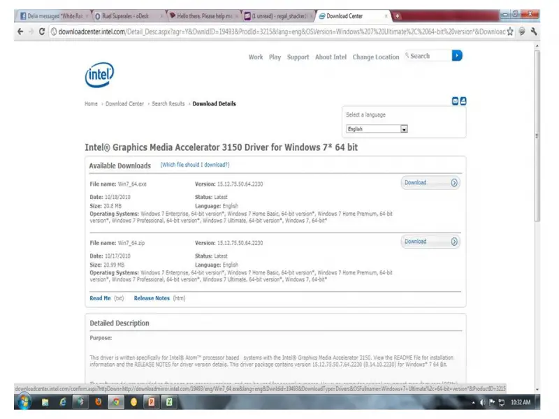

Hello Micheal R,
I have an idea. I hope my idea could help you about your problem. Maybe your computer have no Ethernet Adapter drivers. Try to find the drivers. Install the drivers of your computer. Use the CD Of your computer. Read the computers manual so that you can easily install or fixed the problem of your and after installation reboot your computer if your computer recommended it you. Wait until your computer finished rebooting. After that, try to go to any site you wanted. If nothings happen then contact the manufacturer of your computer. Tell them the problem of your computer, so that the manufacturer will fixed the problem of your computer.
Thanks and Good luck!
