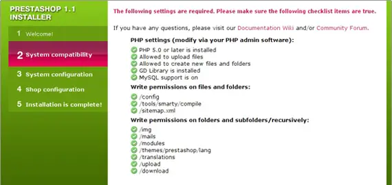

Prestashop is very easy to install and use. Just follow the steps below:
1. Go to https://www.prestashop.com/en and download Prestashop on your system. It is an open source software so you can download it for free.
2. It is a zip file so you will need WinRAR to extract the setup file.
3. After extracting the setup file, upload it using an FTP client. It should be uploaded to the web root folder on your computer.
4. Now start the installation process, you will be asked to select your language and then the software will automatically check your system for compatibility. See the screenshot below:
5. If your system is compatible then the setup will proceed and prestashop will be installed.
