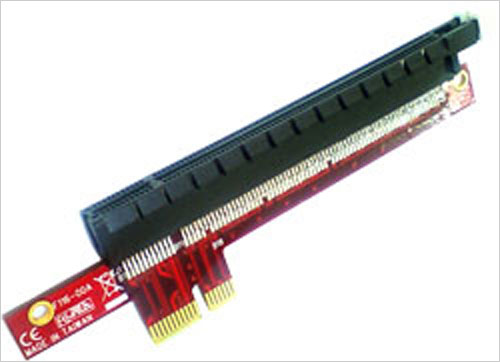

3. Â Buying a PCI-E x16 to PCI-E x1 adaptor.
