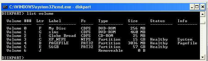

This may not work on system drive or drive C where Windows is installed. And besides, you will not be able to boot Windows if you hide drive C. And also, to see the complete list of commands you can use on the console, type help then press Enter from within the console. For more information, visit [HOW TO] Hide partitions without software.
