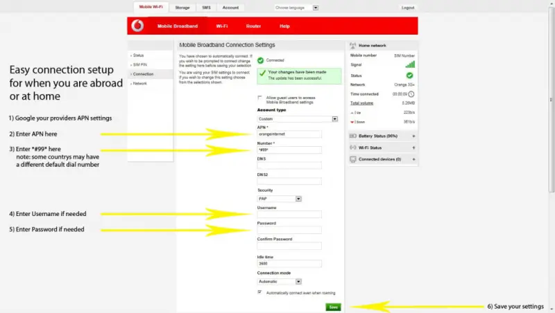

If, however, you're not this unlucky and just can't find the Button to access the storage capacity, here's an image to help you:
This firmware is modified by Vodafone and you can clearly see in the upper area, where the tabs are, the second one being Storage.
